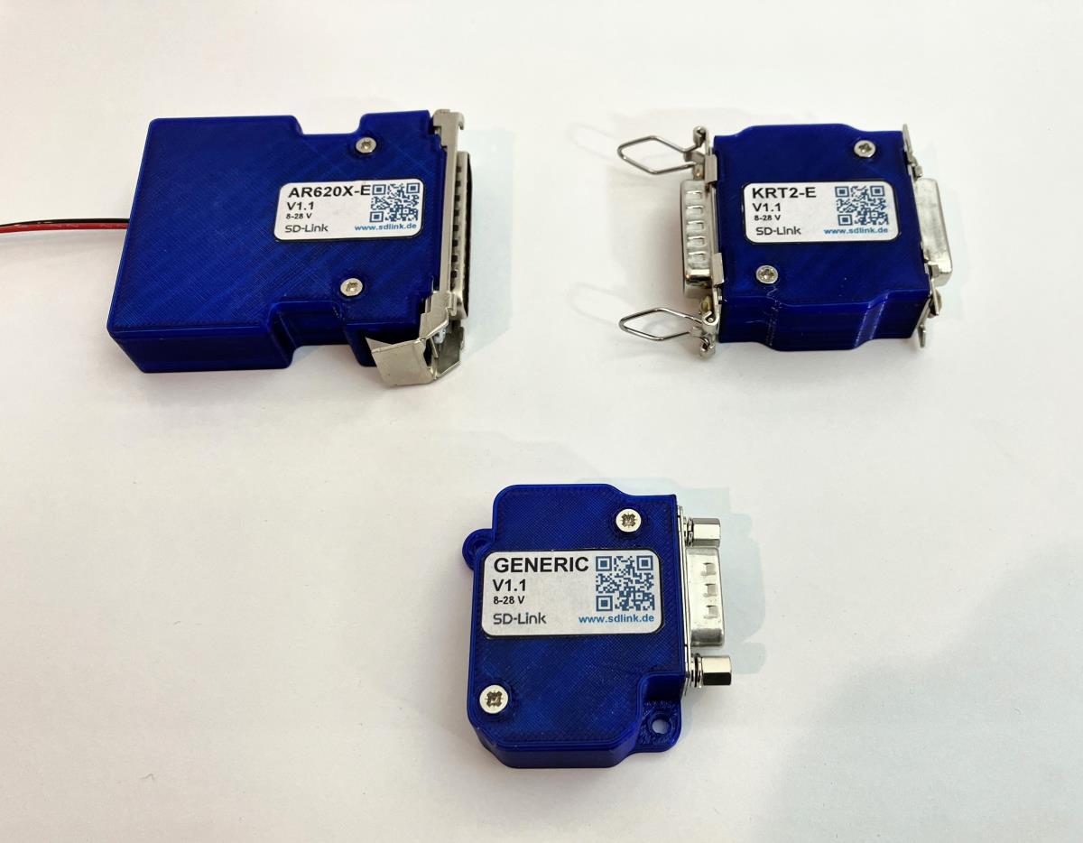

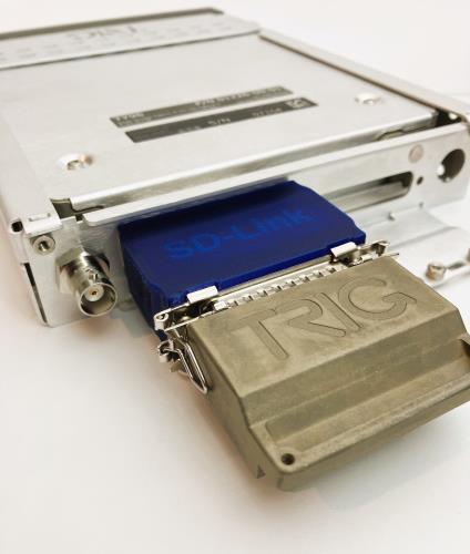

Well...
I have tested theese BT-RS232 modules a lot by my self, it works great with Dynon EFIS-D100 + AP74 autopilot and Trig TY96 COM radio, also without any issue with KRT2 COM radio. You just need to "match" baudrate to 4800 or 9600bps, that should do in this case SkyDemon, afterwards it works like a charm, no drop outs with Samsung tablets or my phone Samsung S23 Ultra.
And all another BT to RS232 work in the same way like this one, all are in the phone as bluetooth com port, all this seems to me much easier and more stable than 3rd party devices which are connected over wifi. Not talking about that you kill your internal data sim when connected to wifi of "ADAHRS" and so on...
This will just work perfectly.
Btw., with this, you can go to compleete system, because when you connect to this serial converter also Garrecht TRX1500 (for example), you can use SkyDemon as traffic display - by using GTX TIS protocol over that single BT-RS232 module.
In the same way i have it with Garmin AERA 760, but planning a route is terrible on that device, but Garmin has built in RS232...
