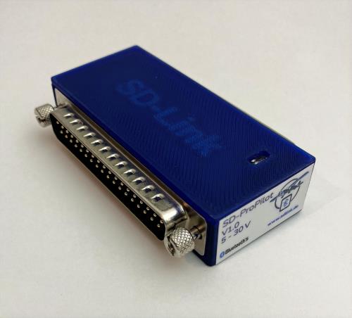

did anyone have successfully established a bluetooth connection for NMEA (FLARM or GPS) - Receive GPS position and traffic information to an Air Avionics Air Traffic AT1?
When I press flying and select "Use AirTrafficAT1"
It's connecting to the bluetooth device
and then
forever.
My setup is:
Using AT1 RS232 Port 2 transmit data (TXD2) to MAX3232 RS232 RX_IN and MAX3232 TTL RX_OUT to RX DSD TECH HM-18

Maybe I'm doing something completely wrong. Thankful for any hint to get it working.
Rob
The AT-1 has BLE built in, you shouldn't need any wired connection or any intermediate RS232 device.
If you do choose to use such a device, you'll need to match the baud rate and ensure that the AT-1 is configured to output NMEA data including GPS and traffic on that specific port.

Hello Tim,
thank you for responding. According to Air Avionics Support the AT-1 has built in BLE if the hardware part# is something like AT1-7xxx with a 7 as first digit. Unfortunateley my AT-1 is quite old and has the hardware without BLE capability. Therefore I need to stick with this approach.
In the AT1 RS232 Port 2 settings I posted, RS-232 data port 2 Protocol is set to NMEA:

You said, I need to match the baudrate. Stupid Question... what is the matching baudrate? I'm pretty sure I went through all of the baudrate options on the AT-1, without succes. But I'll verify that again.
Do I miss anything in the settings here or set something wrong?
I don't know, I am not an AT-1 expert. When dealing with RS232 communications you need to match the baud rate of the sender and the receiver, in this case the receiver is presumably whatever BLE dongle you're using with SkyDemon.
