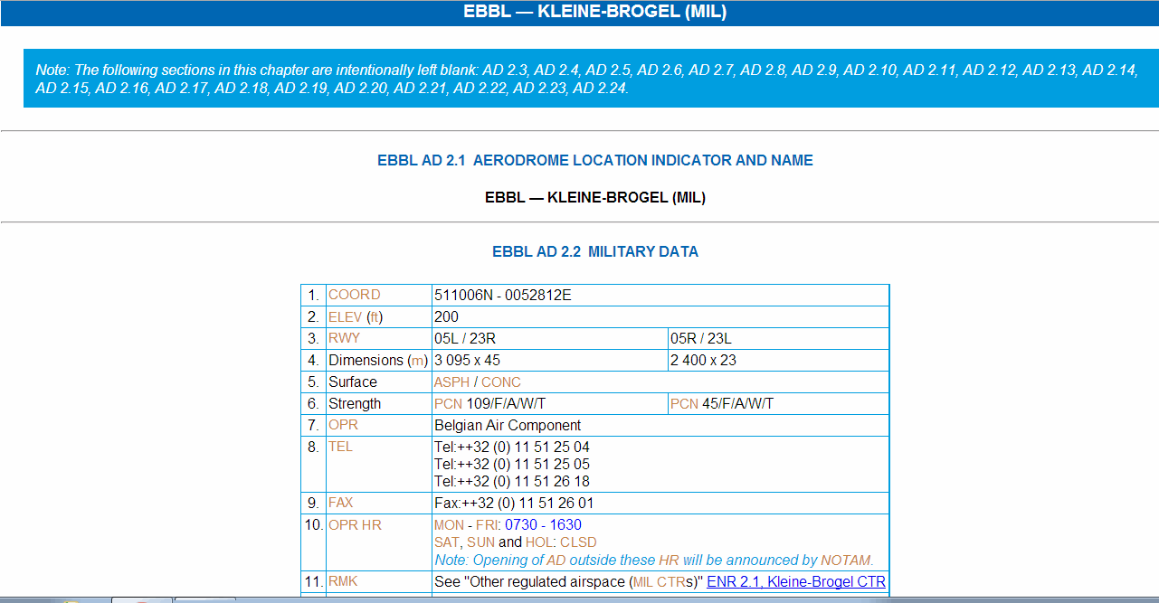

Hello Tim,
From the Belgium AIP the (rwy) info about the (missing) military airport Kleine Brogel Belgium EBBL.
Regards,
Henny

posted 3/28/2014 5:13:03 PM
Posts: 8.3K,
Visits: 10K
Thanks, we have actually already ensured this will be present in the next Belgium chart update.
