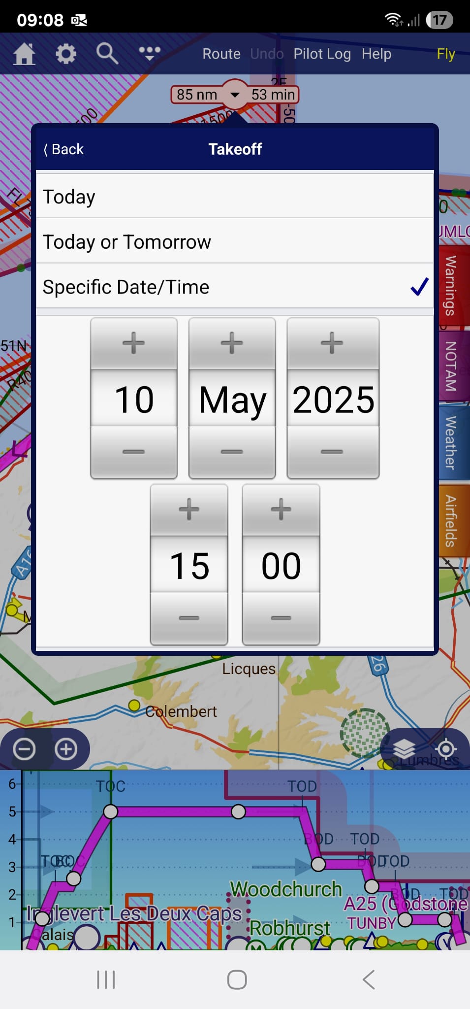

Yesterday I was having trouble with SD reliably crashing and shutting down.  This happened whenever I tried to use the "spinner" wigit to change my take-off time on a route.  I had flown Redhill to Calais and wanted to reverse the route for the flight back.  As i needed a flight plan I needed to enter an accurate flight departure time.  I pulled up the "flight details panel, went to Take-off and tried to spin the hour number.  SD shut down.  I repeated this several times with both the hours and minutes spinner.  After a few moments of incredulity (SD is normally SO reliable) I realised I could type in the numbers I needed and that worked ok.  I had similar problems when I wanted to delay my resulting flight plan - adjusting the departure time through the "Manage my flight plan" facility caused similar crashes and I ended up having to delete the flight plan and create a new one.

There is a bug in that One UI version of Android. We have not managed to find any way around it on the SkyDemon side.

I’m experiencing exactly the same issue when setting the flight time and when sending a delay notification for the flight plan.
I also wasn’t able to manually enter a time to shift it, so I had to do it by phone with DFS.
The issue seems to have started after the update to OneUI 7.0 / Android 15, and I’m using SkyDemon version 4.0.2.0.
I also tried installing SkyDemon on my wife’s phone, but failed right after login during the chart download. Instead of being presented with a country selection, the download starts immediately, but nothing happens — probably because no country is selected. When tapping the back button, you briefly see the country selection menu, but it closes right away and takes you back to the welcome screen.
The same OneUI, Android, and SkyDemon versions are installed on that phone.

Same problem here on my S23. I also can not use the manual input method this leads to a crash as well or the digits are not imported.

We released 4.0.4 for Android over the weekend which replaces the buggy Android time picker with a simple textbox.
cda, could you contact customer support about the issue on your wife's phone, if it's repeatable?

Problem solved, thanks!
