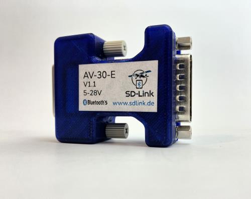

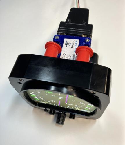

Stephan,
the wait is over. The SD-Link AV-30 adapter is now available. This will turn your uAvionix AV-30 into an HSI displaying the planned SkyDemon legs. The existing AV-Link for the traffic display will continue to function ;-)
It's a simple "plug and play adapter", just plug it in and enjoy the new features.

I just ordered ;-)  If I use it together with the Wifi AV-Link, is it better to have your adapter connected directly to the AV-30 or is it also possible to have it behind the AV-Link?

Stephan,
I would prefer this arrangement. Electrically, the order doesn't matter, but mechanically it provides a bit more stability.
You need more space behind the panel for both adapters - about 50 mm.
If this is a problem, we could also design an angle adapter that saves space and fits tightly against the back wall.
