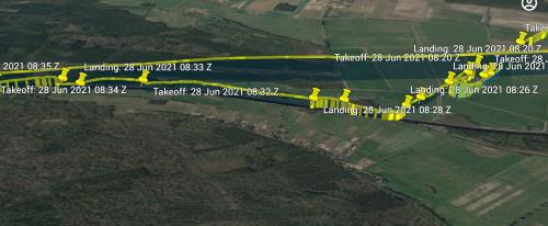

I did some testing today. Logging both Engine Start as well as Off Blocks, I do actually get one continuous trajectory. That is a big step forward and was probably my biggest concern.
However, skydemon still logs imaginary landings. Every time the zoom reverts to the default value, that is now my main concern.
Also (slightly less important for me personally but still a bit of a pity) the post-flight pilot log lists a bunch of very shorts flights between 1 and 5 minutes with large gaps in between. For one flight of 1:47 skydemon gave me a total of 30 minutes of actual flight time of which 15 mins was straight and level transit at the end.
Please note that skydemon logs a landing even though the trajectory is still well above ground level. Most of that track is somewhere around 100ft AGL. Also note large gaps between detected landing and takeoff.
