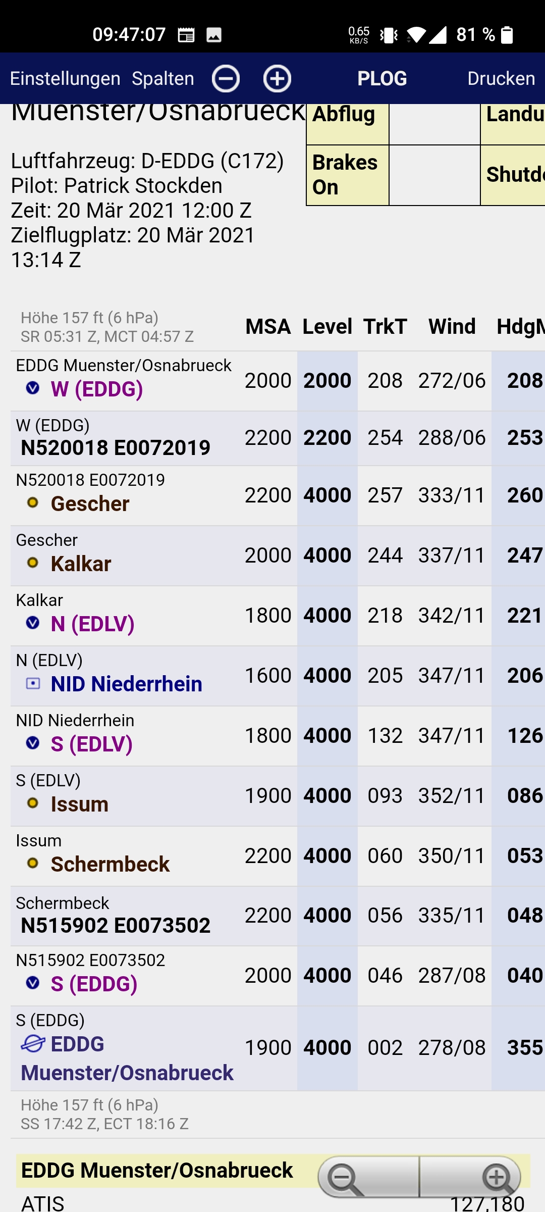

Sometimes I have to use a waypoint that is only known from its long/lat coordinates and not defined by a city, reporting point, airfield etc. (E.g. for the matter I just posted in the thread: intelligent level changes.
In the pilotlog and the briefing pack these waypoint just appear with their coordinates and dont mean a thing when flying. Most of the times I only use these waypoints once, for a specific flight. E.g to avoid overflying gliderareas
Is there an option when clicking on the waypoint (or in the pilot log) to quickly rename it. (E.g. avoid GLDRArea NW Münster or ALT change NW of MS). This renaming only needs to be saved for this particular flight. Benefit: it doesn clog up your favorite, and self created waypoints.

Hi there,
very happy to see that this functions has been added. In the pilog log it works very well, however I think there is one area where the renaming is not included.
In the Route Plan the old name is still shown. I think for consistency reason the renaming should also affect the route plan.
See waypoint "test1", which is not used in the route plan.
