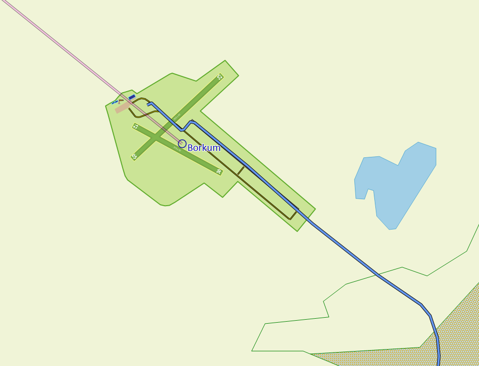

Hi there!

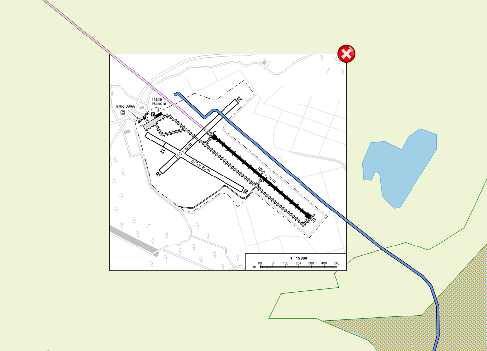

I flew to Borkum (EDWR) yesterday using SkyDemon, and as I susually do, opened the DFS aerodrome map in the navigation screen after landing (great feature, by the way!!!) Unfortunately, the positioning of this map seems to be off by about 50-100m: the DFS map showed me having landed beside the runway, although I'm pretty sure I would have noticed... I checked afterwards loading the track into the PC version of SkyDemon, and see the same problem. The positioning of the aerodrome in the standard SkyDemon map is fine, as you can see from the two screenshots attached ( they show the same track, once with the standard map, and once with the DFS map superimposed).

We have spoken to DFS and Eisenschmidt about this and we have confirmation there is an error in their document. They have said they will correct this as soon as possible. In the meantime we have removed the georeferencing from it. Thanks for bringing this to our attention!
