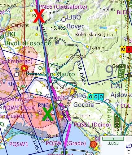

that´s completely right but the thing I (or better ATC asks for) is an ETE to any particular waypoint independent to your planned route in SD.
In the picture you see the red X (our position while havin contact to ATC) and the green X (the waypoint ATC asked for) and you see our planned route (circumnavigating Ronchi CTR, with several waypoints) and our actually flown track through the CTR which was coordinated by ATC.
In my "wonderworld of wishes", when I will be asked at the "red X pos" by ATC "...how long do you need to proceed to Ronchi (airport)?" I would like to tap onto RON-airport to get the "what´s here"-screen and see the ETE instead or maybe together with the distance to that waypoint.
Italian ATC (maybe others too?) loves it to ask for that often on VFR-Flights.
