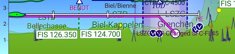

SkyDemon has never shown the boundaries between FIS sectors on the map - there is no need for such a display on a dynamic chart.
We do show the boundaries in Virtual Radar, where we even show you the upcoming frequency to change to as well. Also, you can long-press on the main map to see the FIS frequency at any area, and when you look at it, its border is shown temporarily. ‌‌

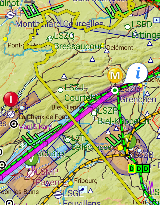

Here's an illustration of what Tim says about seeing FIS in virtual radar, and ok no the chart when drifting by "what's​here".  According to me, the flight you are describing (LSGN-LSGY-LSGL-LSGN) all taked place in the Geneva FIS area. I personally always have my oaci paper chart available. I could imagine that having the possibility, in "layers", to choose to show our not the FIS areas could be an elegant solution.
Cheers‌‌,
