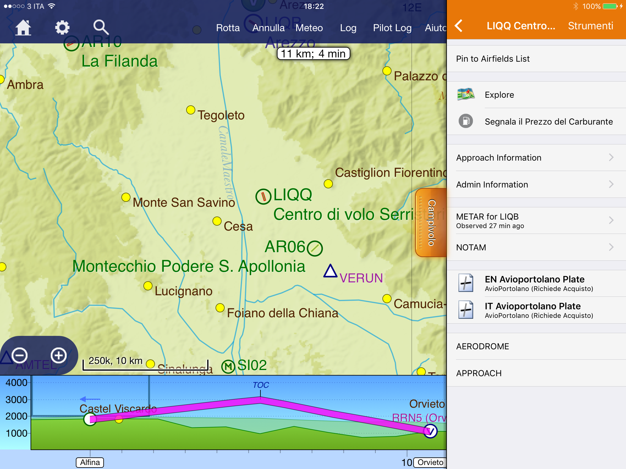

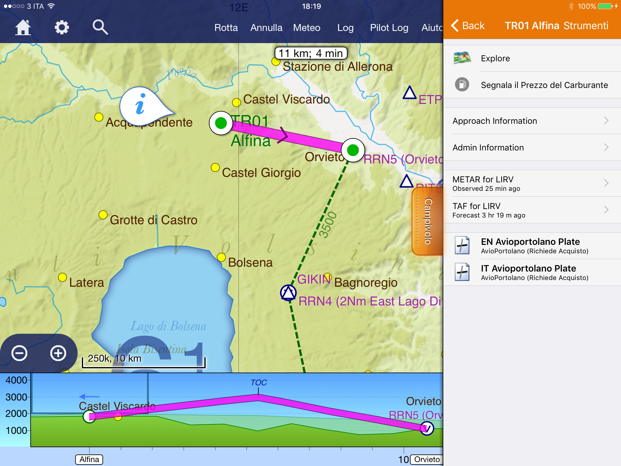

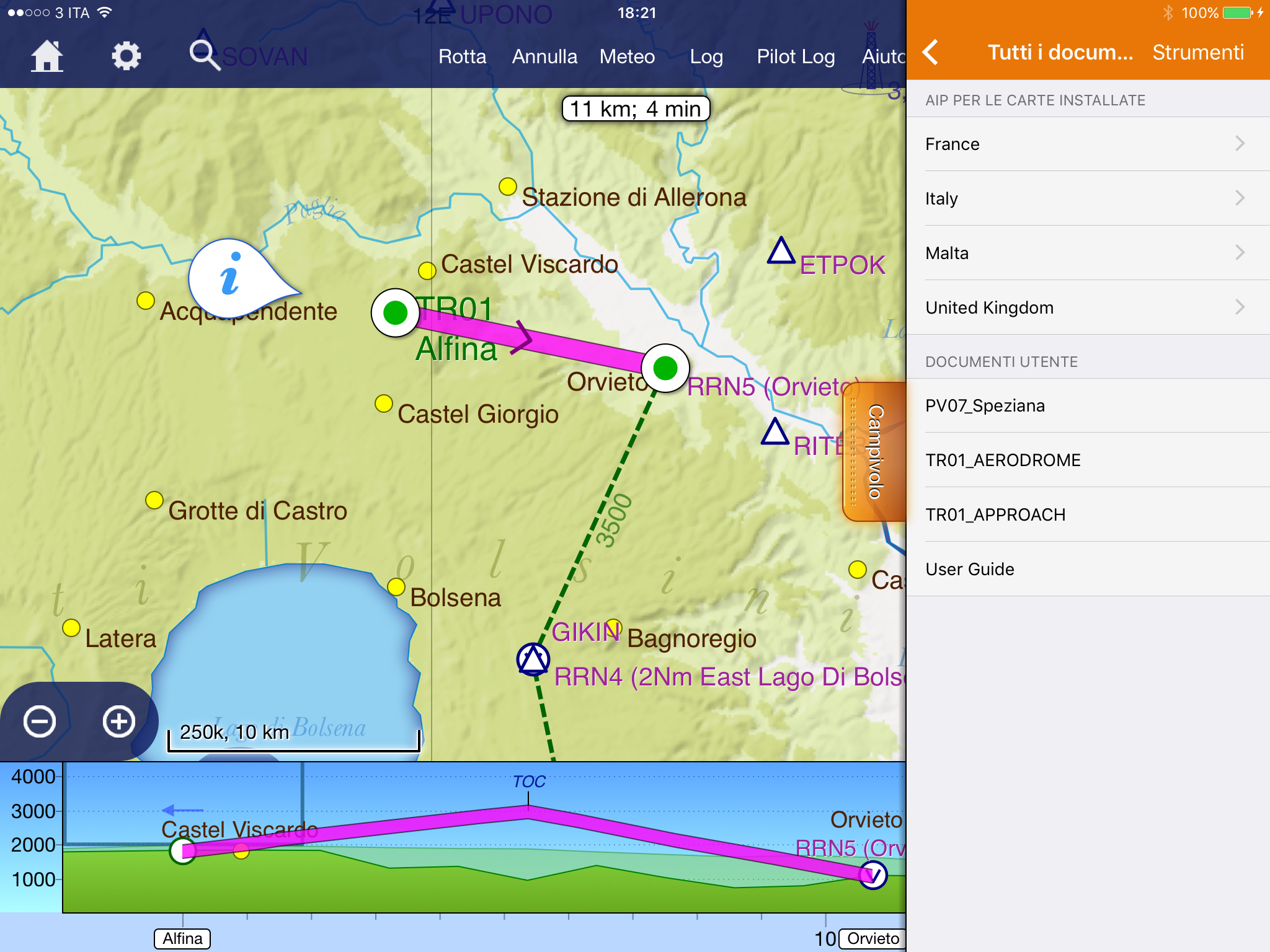

‌I name the file TR01_approach.pdf and uploaded with LIQQ_approach.pdf file on custom data on my iPad, the LIQQ_approach.pdf I could see at the bottom of the LIQQ airfield page, but TR01_approach only on User document. It seem that only real ICAO name will appear on airports detail page.
‌Look at attached files: SkDem show the list of files on iPad, 18.19.50 show you the TR01 page without the TR01 plate, 18.21.27 the plate as user files and 18.22.31 an example of a LIQQ with the correct files/plate  on the airport details.

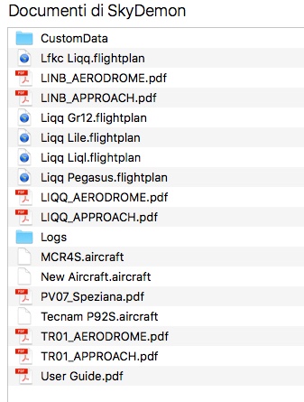

‌If you look carefully at the list of files on picture SkDem-2.jpeg you will find 4 files with real ICAO designator: LIBN and LIQQ, each have approach and airport plate, wile the TR01 and PV07 are not ICAO designator but just a code, that's why are not visible on relative pages.
