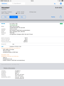

today I encountered that the METAR forecast seems to be wrong interpreted in terms of IMC via VMC. See attached screenshot that shows deviation between skydemon and aeroweather whereas aeroweather seems to be correct.
METAR states few in 3000ft at EDDL which is IMC for skydemon but VMC for aeroweather (and myself).

EDDL 061220Z 34008KT 300V020 9999 VCSH FEW030 SCT040CB 26/17 Q1019 TEMPO TSRA
then SCT040CB and TSRA makes it look like IFR is possibke to me even if TEMPO!

mmh. not quite sure about that. My previous posting referred to the METAR issued at 1120Z and there was nothing about SCT040 but FEW030. Anyway: Why should SCT (aka 3/8-4/8) shoud justify IMC reports?
It might be related to the kind of clouds - here CB, as the original TAF (see previous Screenshots) mentioned SCT030 and ist marked as VMC. The METAR mentioned the same ceiling but with CB.

Right now the icon in the chart still states IMC for EDDL, here goes the METAR:
EDDL 061250Z 03008KT 350V070 9999 VCSH FEW030 SCT 040CB 27/17 Q1020 NOSIG
It must be due to that specific kind of clouds (CB). @Tim: Am i right?

To me, CB means IMC and, looking at your METAR, I second Skydemon's interpretation.

This is just your personal opinion and I would somehow agree but it is interesting, that other tools calculate the other way around.
Whether a situation is IMC or not is based on some defined facts as visibility and ceiling depending on the surrounding airspace. As far as I know CB is none of these facts and most of even the commercial flights that operates under IFR would probably avoid CBs as well.
Therefore CB - to my opinion - will not lead to IMC (which implies legal issues when operating under VFR) but every pilot should be aware of and take his/her own decision. Once there is a common definition of a "meterological state" no tool should mix it up with interpretation even if it is for safety purpose. Just my 2ct.

What SkyDemon decides is V/M/I conditions is almost entirely up to you, as the user. You are encouraged to set your own minima with which you are comfortable, ensuring that the V/M/I indicators are actually useful to you.
One of the triggers over which you have no control, however, is the presence of CBs. That does (as hypothesised above) trigger the I indicator.
