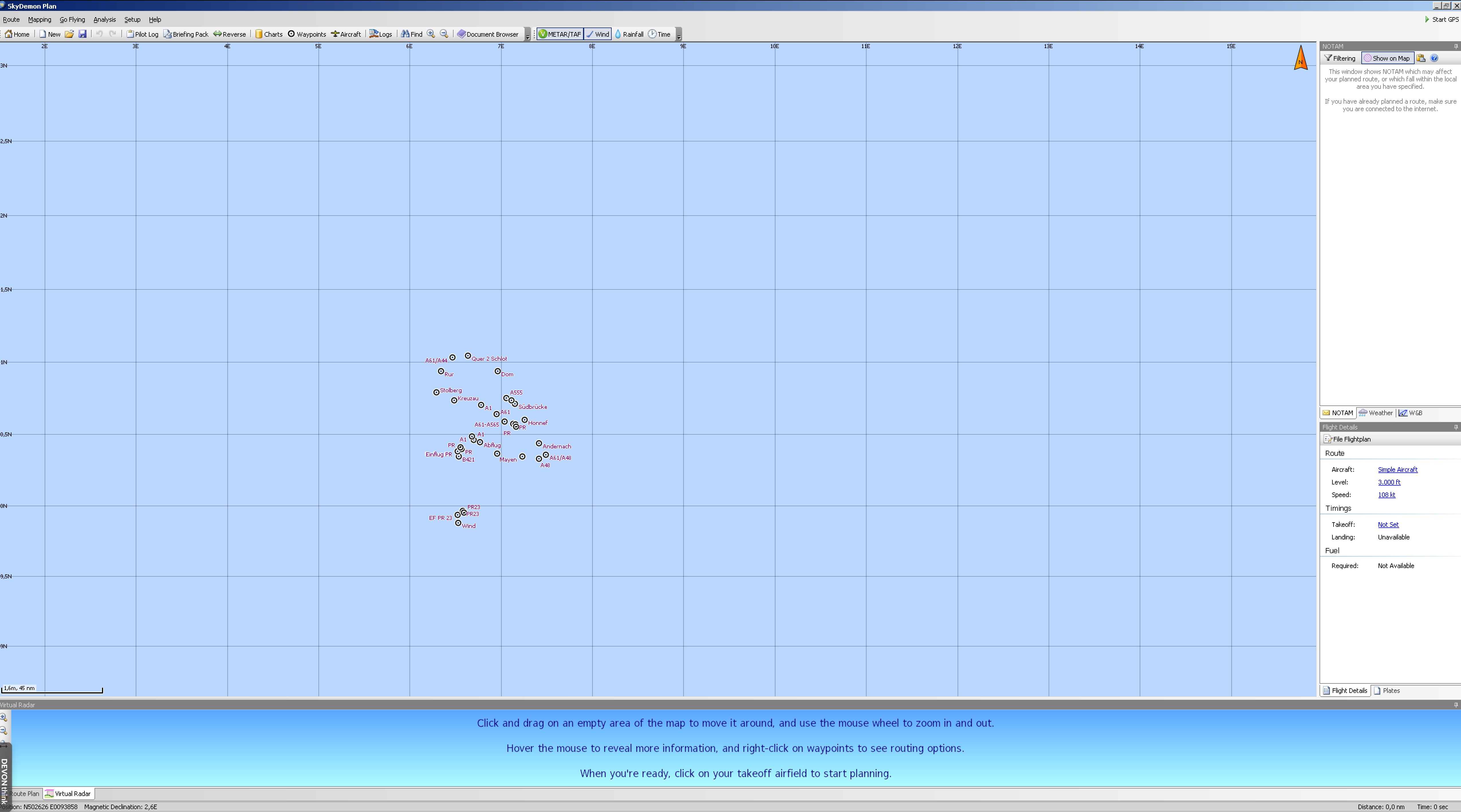

what point does it freeze at?  Do you get as far as the VFR warning pop-up?
cgndemon
Too Much Forum (447 reputation)Too Much Forum (447 reputation)Too Much Forum (447 reputation)Too Much Forum (447 reputation)Too Much Forum (447 reputation)Too Much Forum (447 reputation)Too Much Forum (447 reputation)Too Much Forum (447 reputation)Too Much Forum (447 reputation)
Posts: 5, Visits: 3
It freezes after the VFR warning  as soon as it starts to draw the map. What is a bit weird: Even if I delete the content of the SD folders and only add my "license file"  - it shows the icons of my waypoints

cgndemon - 7/29/2017 5:38:25 PM
additionally try deleting the contents of $HOME/Library/Application Support/Divelements Limited/SkyDemon Plan

@rikur
‌You got it! This was the crucial part. I deleted $HOME/Library/Application Support/Divelements Limited/SkyDemon Plan - and it started up again.
I did not check everything completely until now - but at the moment, it looks great!
