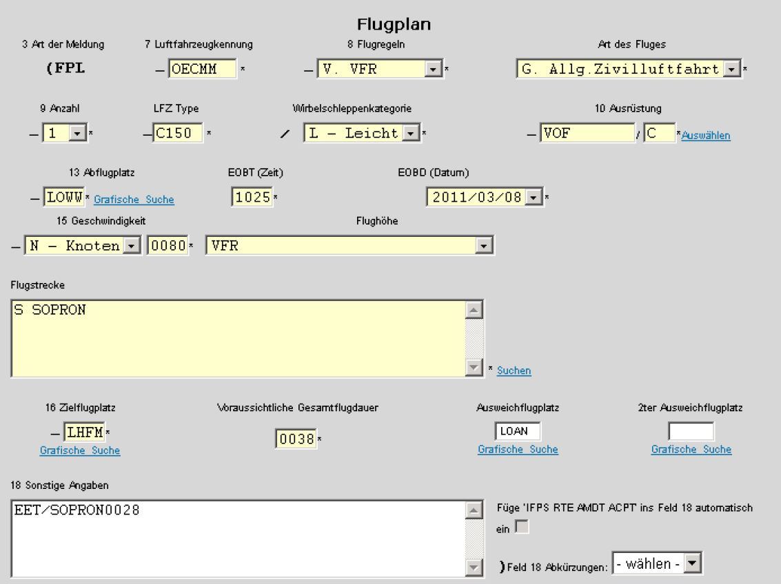

I just checked instructions on how to file an ICAO flight plan and found the following:
When not on ATS routes, the route may be specified using significant points along the route using 2 to 11 characters. The coded designator assigned to the point may be used (e.g., LN, MAY, HADDY). If no coded designator has been assigned, use one of the following:
Degrees only (7 characters) or degrees and minutes (11 characters).
I also checked the official guide lines of Austro Control which were updated in 2012 to reflect some changes made in the filing format (concerning the equipment codes and other information fields). Attached is a VFR flight plan specifically given as an example in their instructions. The flight is from LOWW to LHFM. The point at which the flight exits LOWW CTR is S and the border crossing point is SOPRON. Both NEED to be given as names in the route field.
Furthermore, Austro Control states that extraneous DCT's are to be avoided. Therefore there is NO DCT anywhere in this flightplan. DCT is only to be used when joining or leaving an ATS route.
