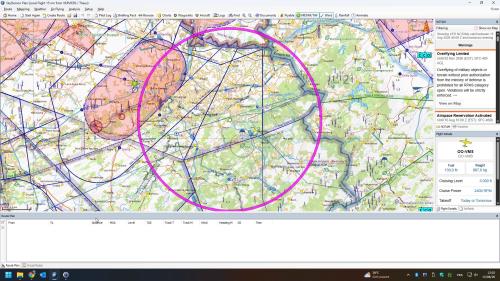

In SD (PC) no display of this one this morning

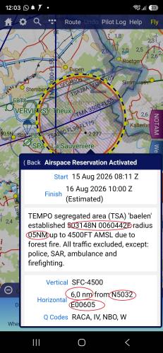

On Android device (Samsung S24 ULTRA), the notam appears but there are diffirences between the notam text and the notam docoding ...
But perheaps it's for an easy way to dispay that coordinates are rounded and circle is greater

My mistake for the display in PC version, 'Show on Map' was not activeted :-(
But the other on Android, will be happy to know the raeson of difference.
SkyDemon Team (725K reputation)SkyDemon Team (725K reputation)SkyDemon Team (725K reputation)SkyDemon Team (725K reputation)SkyDemon Team (725K reputation)SkyDemon Team (725K reputation)SkyDemon Team (725K reputation)SkyDemon Team (725K reputation)SkyDemon Team (725K reputation)
The "Horizontal" part of the What's Here menu is showing you the Q-line of the NOTAM. SkyDemon is usually able to extract more precise coordinates from the E-line and use them on the map.
