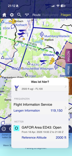

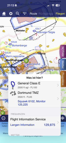

in 2025, there was a trial in Germany for the so-called FMC (Frequency Monitoring Code). It works similarly to a TMZ (Transponder Mandatory Zone) with a specific squawk and a monitored frequency.
For 2026, the FMC trial operations have been extended to additional Flight Information Service areas.

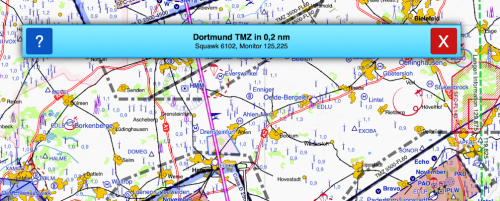

It would be very helpful to have the squawk and frequency information available in SkyDemon—at least in the "Information" pop-up. Even better would be a proactive pop-up when approaching the related FIS area, similar to the existing TMZ reminder.Is this feature already planned, or have I perhaps missed an existing setting?

I think we added these areas a week or two ago, you should be seeing them.
