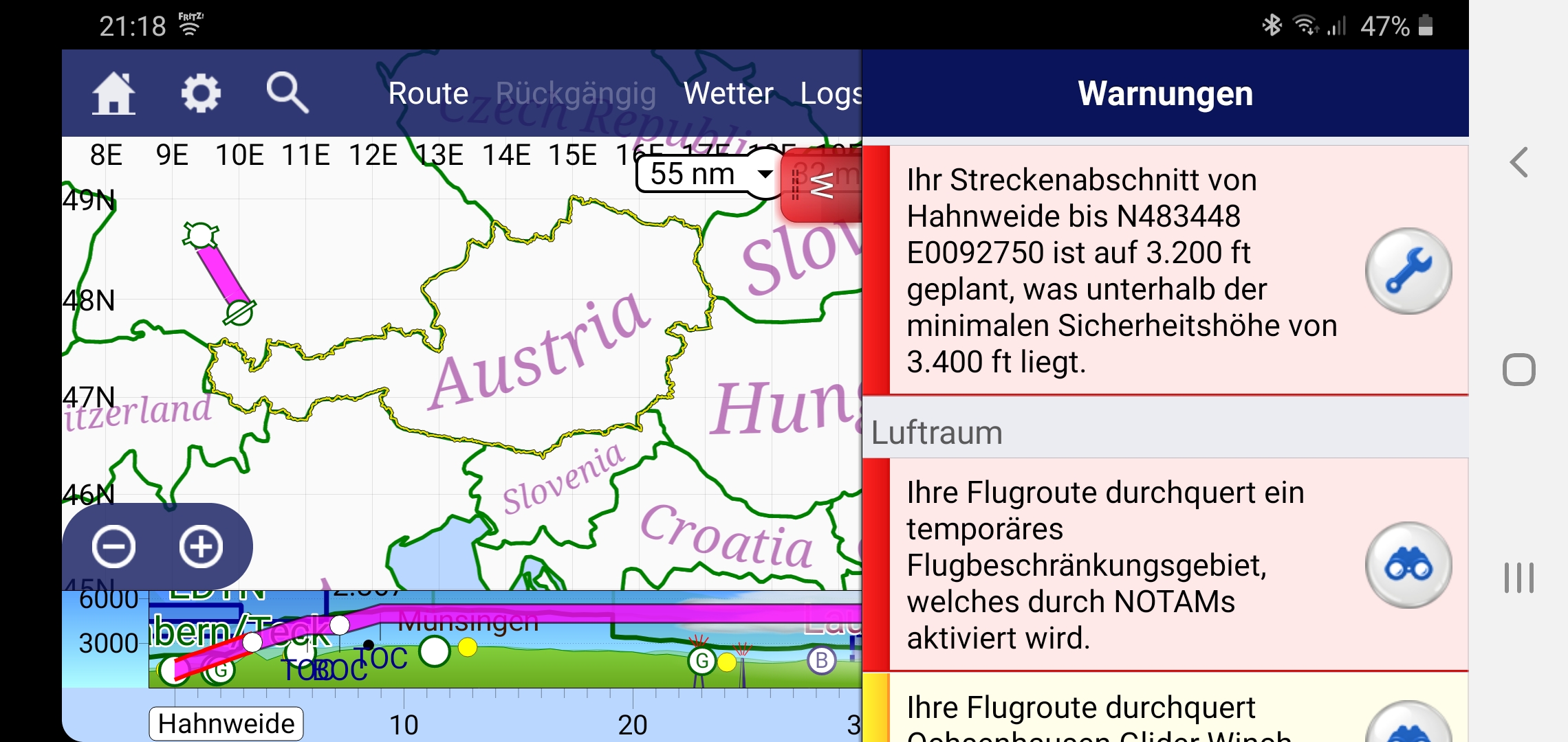

I have a planned route in Germany and get a Notam "Your route is crossing a restricted area...." where the highlighted area is Austria.
Bug or feature?

Looks like an incorrect interpretation of TRA Vorarlberg. AIP SUP 2019-12
=> bug
It's a badly-published NOTAM. And the text doesn't say your route goes through it, it says your route passes through the effective radius. Austria have decided to publish that NOTAM with a 999 mile effective radius, which is unfortunately going to trigger that warning as long as the NOTAM is effective.
It only takes a second to analyse it and determine that it isn't applicable to you.

Sorry, Tim, but the text reads that the route crosses the TRA. At least the German text says this.
Edited 1/20/2020 7:12:57 PM by efrenken
Thanks; we will get that corrected.
