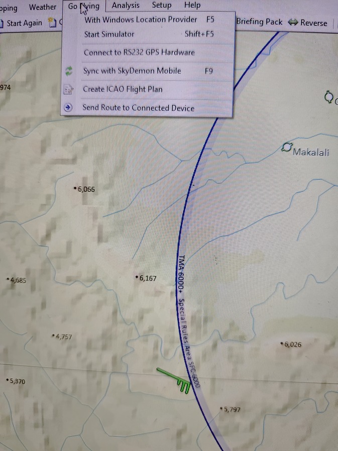

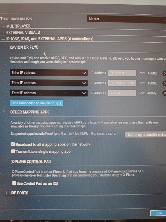

Hi ..I tried following the above things ..but can't connect my xplane to skydemon within same PC . There was an existing iP address 192.168.0.1..i added 2 more, one is my PC IP address (through cmd-ipconfig/all) and other is 127.0.0.1 (local host), but still there is no option in skydemon PC which says "use xplane" unlike skydemon mobile which has such an option..
Under "go flying" in skydemon PC , there is an option which says "sync with skydemon mobile" .it asks me to install windows mobile device centre first..but i think even this option will just share routes etc between 2 devices and not mirror the skydemon mobile onto my PC..?..
Is there any other way..?..

SkyDemon Team (698K reputation)SkyDemon Team (698K reputation)SkyDemon Team (698K reputation)SkyDemon Team (698K reputation)SkyDemon Team (698K reputation)SkyDemon Team (698K reputation)SkyDemon Team (698K reputation)SkyDemon Team (698K reputation)SkyDemon Team (698K reputation)
Setup -> Third Party Devices
