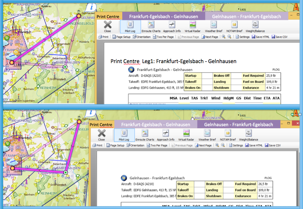

P.S> the print center question is very valid and a) print center needs a better highlighting witch leg you are currently printing as well as either a selection box, where you can select witch legs to print or at least to jump between the legs (little mockup attached)
Hope this helps
