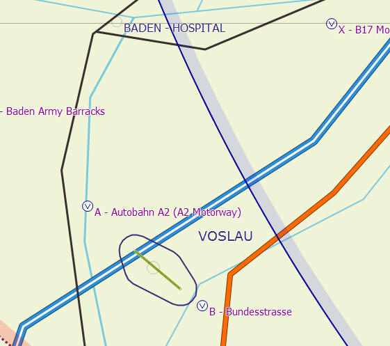

The placement of the Bad Vöslau Runway LOAV is totally wrong, the Motorway A2 goes directly thru the runway...

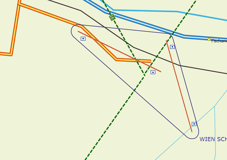

The Placement for Vienna Airport is wrong as well as a rural road is going over the LOWW runway 09 twice

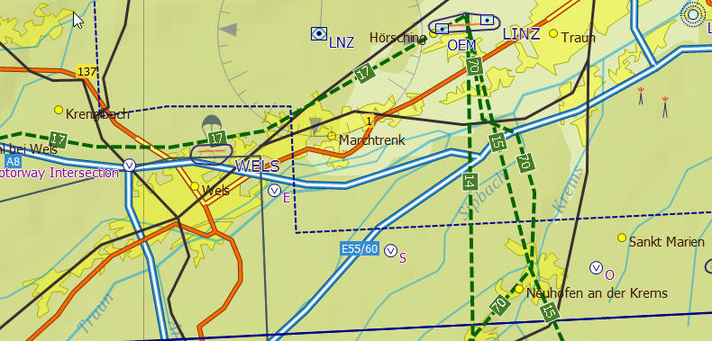

Thé Placement of the runway for Wels Airport LOLW is wrong as in reality the runway is south of Motorway A9 and not North of it

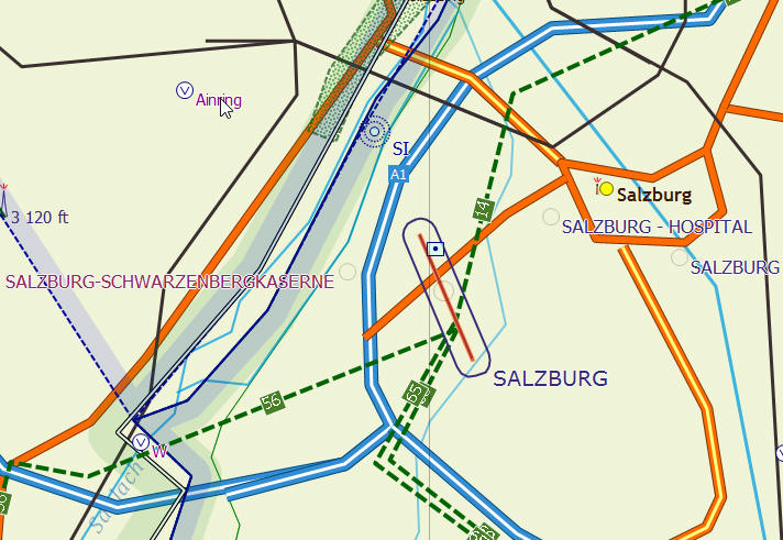

In Slazburg Airport LOWS aroad is crossing the runway....
I stopped checking here, but there seems to be a systematic error in this Chat. I have attached screenshots so you see immediatly what I mean
