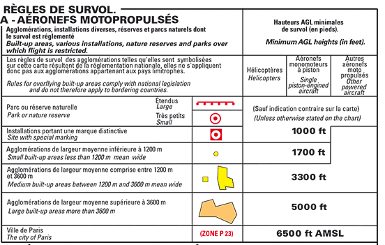

The no overflight data is published in the AIP, though, so we could in theory incorporate it. It's unusual though because they are just points with no area, so it is not clear what radius the pilot should avoid. How are these sites represented on printed French charts? Could you share a photo of one, perhaps?

As regards the no overflight areas, I've attached the original map legend. The representation is the "site with special marking" one (white circle in a red square).
Looking at the official definition of these areas, there is no formal attached radius, it's just "prohibited low overflying" (1000 ft AGL for helicopters and SPE, unless otherwise stated on the chart).
Perhaps applying the same rule than for an obstruction can be enough (except from the symbol and warning message). I'm not sure of the radius SD uses for such areas but it seems to fit the use case here.

Thanks, we will add this to our development list and discuss the addition at our next development meeting.
