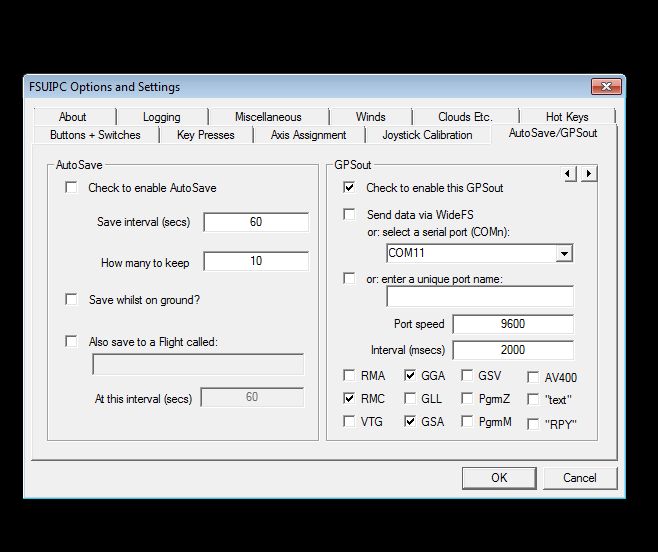

Just to say I got this working, although it was by trial and error and I possibly paid over the odds to do it (worth every penny though, Full blood FSX with Skydemon is just amazing*).
I needed:
FSUIPC (25 quid odd)
WideFS (25 quid too and I'm not sure I actually needed this, but I was pulling my hair out till I brought it then everything seemed to just start working)
VSPE (Free edition)
Once these were installed,
- In FSX Add-ON menu set FSUIPC as per the attachment - (Use GPSout setting in short)
- Add the following to the WideFS WideClient.ini file:
[GPSout]
Port=COM11
Speed=9600
- Use VSPE 'pair' option from COM11 > COM12
- SkyDemon then sees the FSX GPS output on COM12.
Something like that worked for me anyway!
