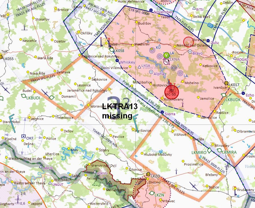

I found an error on the LKAA airspace map:
The space LKTRA13 has stopped being displayed.
LKTRA13 disappeared at the time when the new space LKTSA80 was created, which is horizontally within the same boundaries.
I first reported this issue last year on 10/7/2025. You fixed it and now the error is recurring.
LKTSA80 for drones will be with us forever.
The map image is attached. I used the image from last year because the situation is the same.
Version 4.2.4.0, latest update.
Thank you for bringing this to our attention. We will restore that piece of airspace today and perform an investigation into how it disappeared, so we can ensure nothing like this can happen again.
