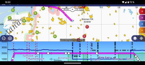

Just a short note to let you know that Skydemon Beta Dated 2025-04-15 is not working properly on Pixel 6 with Android 15.
The upper part of the screen is hidden so the top buttons cannot be accessed anymore.
On my other Noname Android Tablet Device the app works very well.

Thanks, do you have a photo or video showing the behaviour? Does the problem resolve itself if you rotate the screen?

Hi Tim, as you can see, the upper and lower areas are missing.
Previous versions were OK.
Unfortunately, rotating the screen does not resolve the issue.

Thanks Diplomat, I know what this issue is now, and hopefully the next beta will resolve it.

We've published a new beta that we are hoping will resolve the issue with toolbars appearing underneath system bars. Please let me know here whether it helps or not.
