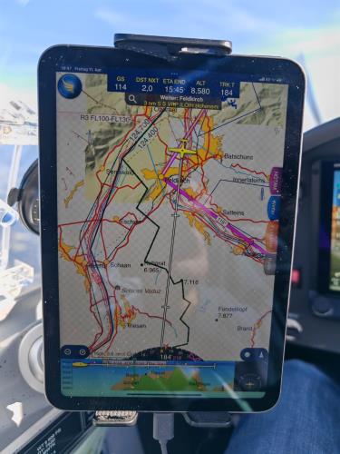

After AERO I flew through the alps. I made a screenshots, how the SD screen looks like (not for a moment, for minutes!), as soon I switched on "color high terrain".
If I fly oin high terrain I really want to have this feature! On an actual device this should run without any issues.
