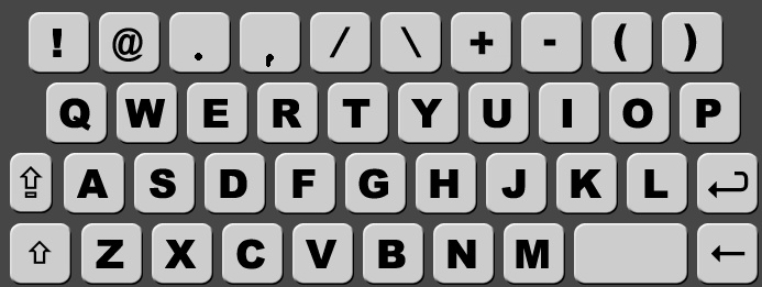

The problem with using LargeKB on 480x272 devices is - as you can see from your screenshot - that it completely covers the search results.
I could, if there was demand, do a version of my keyboard which is targetted at 480x272 devices. There are many keys on LargeKB that are not needed - all that SD actually needs is 0-9, A-Z, Backspace and Enter.
Here's a simulation of how it would look. Note that we've saved almost 40% of screen real estate, yet the keys themselves are actually still the same size.
