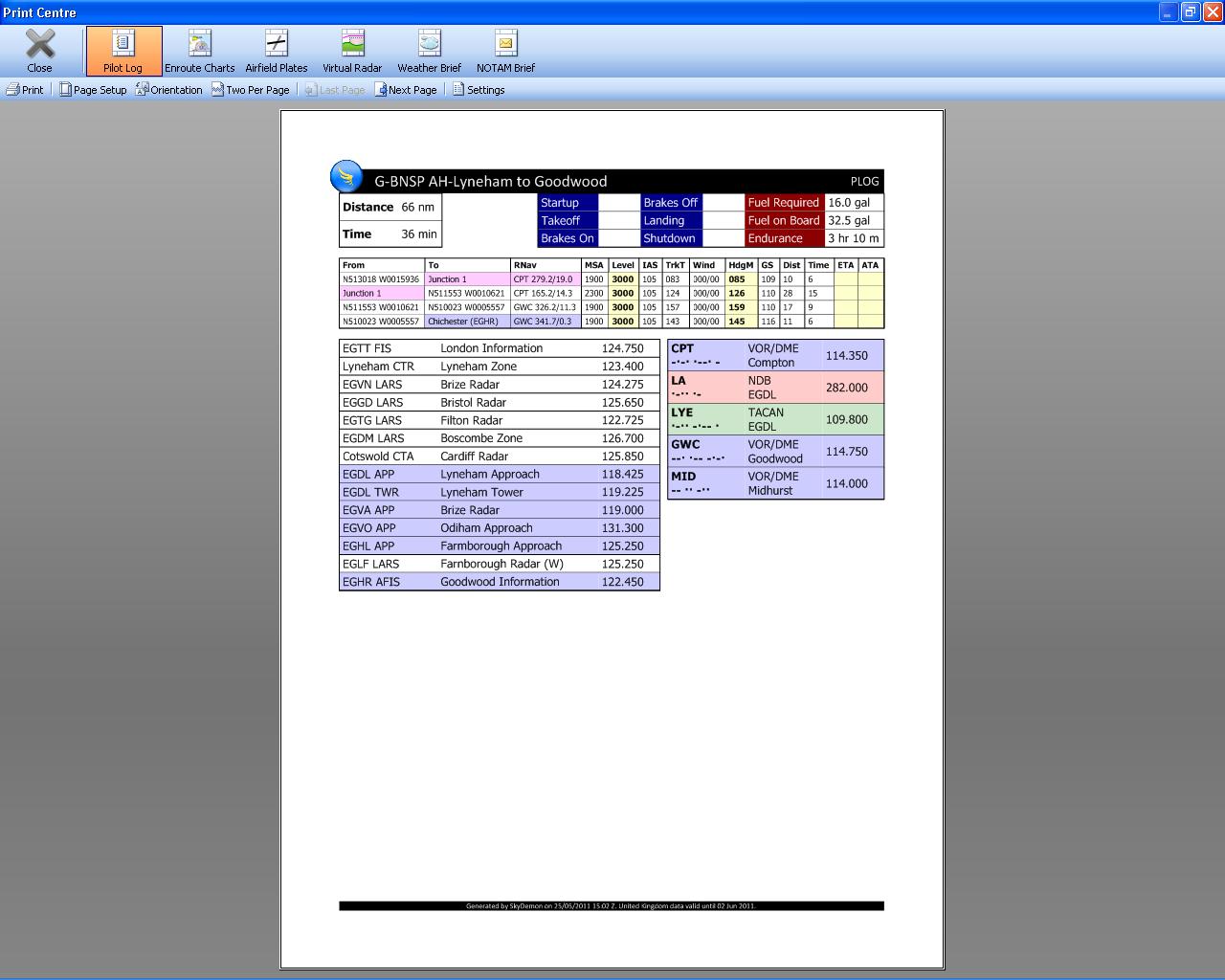

If I plan a flight from RAF Lyeham, the PLOG that is generated has stopped including their Ground frequency (129.475). It is correctly listed on the airfield plate within SkyDemon plan.
Any reason for this? Caught me out the other day when I came to call for start clearance!

It's attached (had to rename it to a .xml because I can't upload routes directly). I've also attached a screen capture of the generate PLOG.

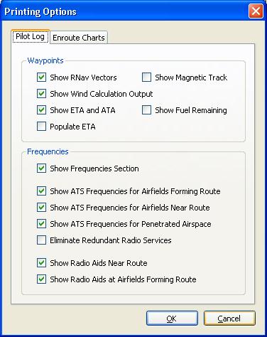

In the settings bit of the print centre, I have all of the 'Frequencies' options checked, with the exception of 'Eliminate Redundant Radio Services' which is unchecked. I've uploaded a screen capture of that too.

Also, do you do anything as regards the order that the frequencies are displayed on the PLOG? For example, even though Lyneham is the start point, the first frequency listed is London Info. Lyneham Tower is the 9th frequency listed.

Thanks. You need to drag the start waypoint off Lyneham and back on again, whereby it will show a green dot in the middle indicating it has snapped to the airfield position. This is something we've managed to eliminate in the forthcoming build of SkyDemon and is basically happening because the ARP coordinates of the airfield have changed very slightly since you planned your route.
