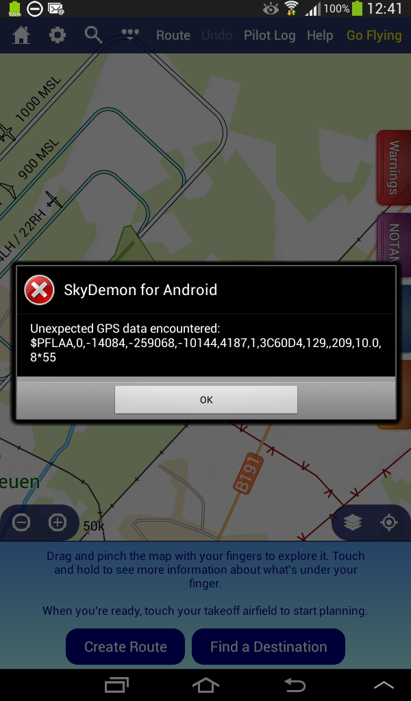

I try to use SD together with TRX-1500 Flarm and Airconnect. On almost every flight I get an "Unexpected GPS data encountered" messages popup. It always complains about PFLAA and PFLAU sentences which as far as I can tell are position reports Flarm receives.
Unfortunately it is quite annoying that SD seems to open up 3 to 10 popups (the amount seems random...) about the same sentence and simultaneously kicks itself out of navigation mode. In my opinion this behavior does not contribute to flight safety since you have to fiddle around to much to get SD back and running! And as a side affect, the flight log is broken which means that if I used one of the time tracking functions, they won't spit out a usable result after the flight.

What you are describing is a significant problem with the traffic receiver you have chosen. We have hundreds of customers using that device without any problem, so you should really consider contacting the manufacturer.
If a traffic device starts behaving not to protocol, we immediately shut down communications with it because that is dangerous. That is our policy and it ultimately results in a higher integrity of data, and a more trustworthy experience. You could argue that we could quietly ignore a misbehaving traffic device, but it sounds like yours is behaving really badly and I don't have a problem with what we are doing.

Anyway, I worked through the screenshots I took over the ast few month in order to find anomalies within the data. In the attached spread sheet (Libre Office) you can find different sentences which were rejected by SD. They are pares into the spreadsheet like the CSV import would do (fields would be comma separated).
The column headers are the data structure from FLARM's latest data port interface control document(FTD-012, V7.10). I used current firmware for the TRX-1500and FLARM and the latest SD-Version in Google Play for all tests. So I assume that the FTD-012 document applies to the TRX-1500, too, since it is essentially a PowerFLARM working within.
What I see at first glace is that first, all of the PFLAA targets are quite far away. Also in all sentences the amount of fields does not correspond to the specification and that the order of the fields seems to be messed up.
Anyway, the checksums are still valid.

Thanks Florian, that's really helpful. Just testing with the first sentence it's obvious that your device is sending very bad data. The checksum is correct, which means the data was NOT corrupted in transit (SkyDemon would have ignored it in that case).
$PFLAA,0,-14084,-259068,-10144,4187,1,3C60D4,129,,209,10.0,8*55
The sixth field in that sentence has a value of 4187. That field is called IDType, and is supposed to have a value from 0 to 3.
We are correct to not only reject that data, but to do so forcefully. A device outputting such bad data has obviously got itself into a very poor state and goodness knows what other bad data it will be putting out.
