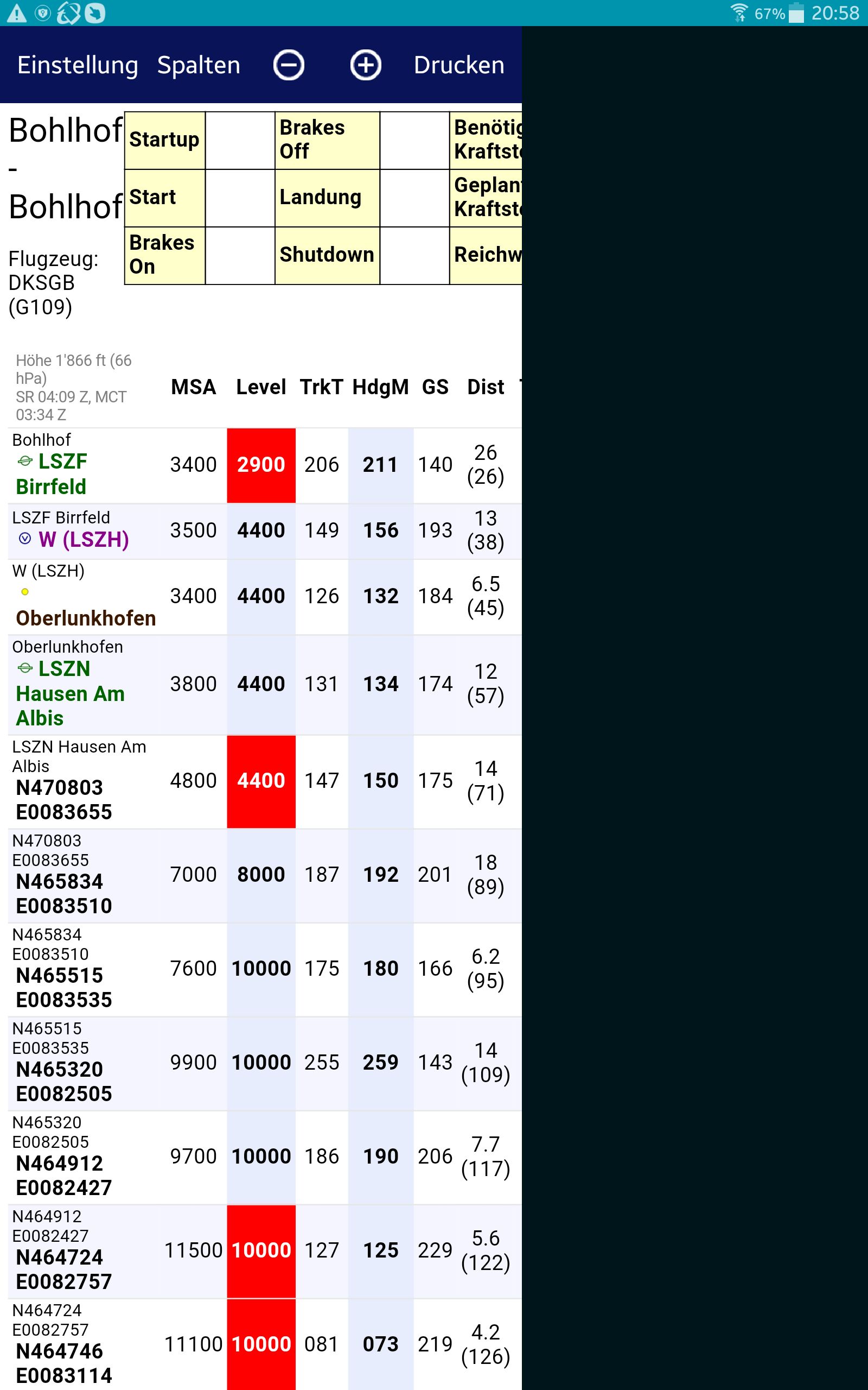

1‌. I cannot get a full view of the pilot log, see attachment.

-‌ pilot log only uses the left half of the screen (the right side is black)

In Simulation mode, the problem with the plog (right 1/3 screen blank) has been fixed.

The pilot log bug, seeing only 2 third of the plog, is fixed, but now it sometimes blinks (like rebuilding the information/display). Very good: the screen response time improved (or does my tablet have a better day?). This slowing down issue ... the SD team seems to have found the reason. With almost all map information being displayed (including terrain, trees, some weather info) I hovered over the map for several minutes, opened airfield plates, ran simulations ... and it still worked.

Tim,
‌it is difficult to describe.
- I plan a route and open PLOG.
- Black screen for about haf a second, then PLOG opens correctly
No simulation running, no moves, ... and suddenly SD starts switching plog/black screen/plog (1-5 times in direct sequence)... looks like the PLOG table is re-building. Cannot provoke that behaviour.
