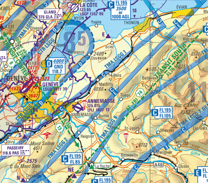

here is a small snapshot of the swiss icao vfr chart around geneva:
https://www.eisenschmidt.aero/media/image/thumbnail/fpch_flight-planner_icao-ch_720x600.png
