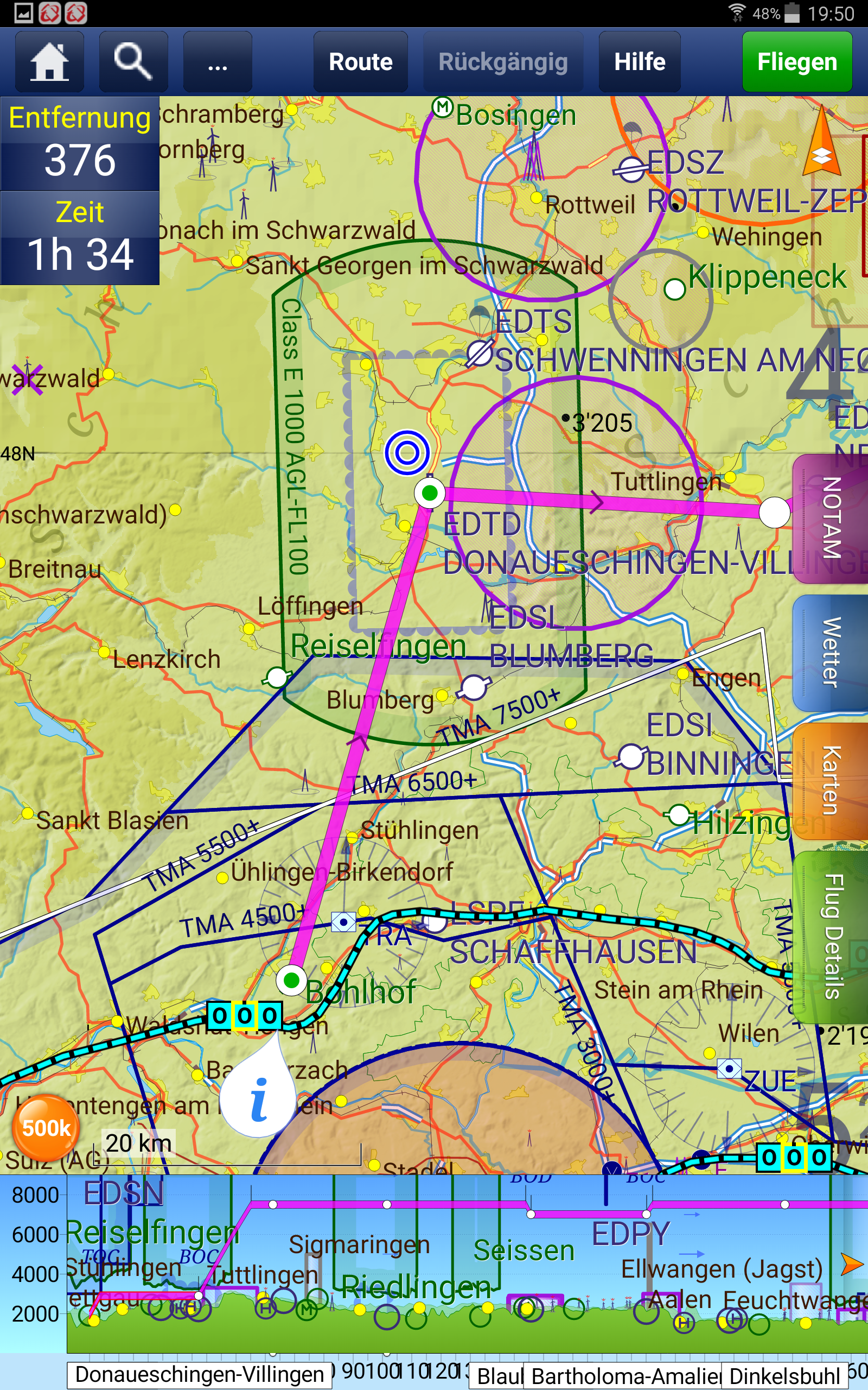

I was wondering why no railways are displayed on the map although I had ticked the box in the map settings ... until I noticed those VERY VERY THIN grey lines. Practically invisible in flight - I tried with 2 devices.
I like using railways as landmarks and propose to use the same thickness as assigned to country roads. Or can I adjust it in the program user interface and I just did not find it?

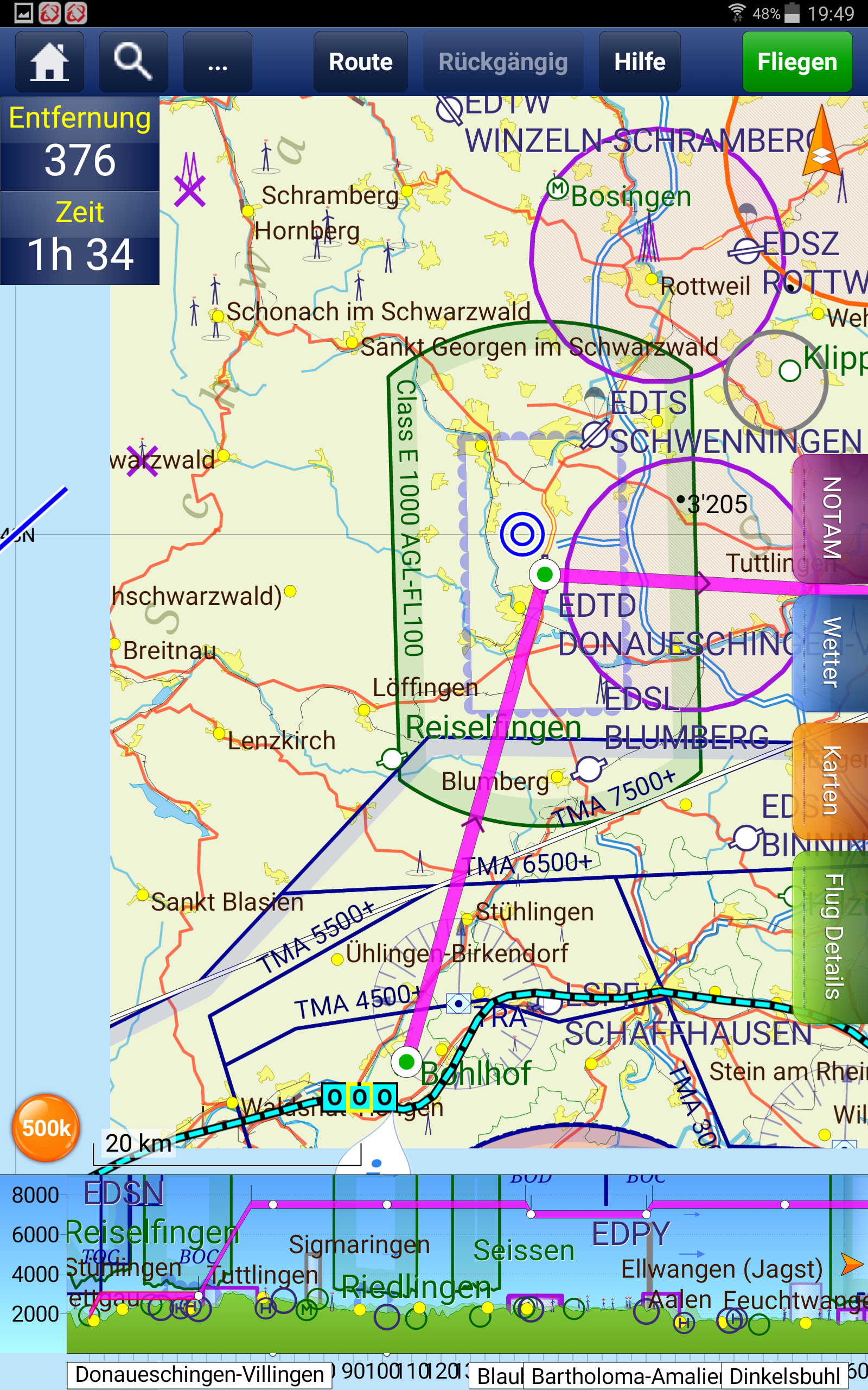

Hi Tim, here you are. While you may spot the railway south of Blumberg when the terrain information is switched off (but even that becomes very difficult in flight, as the line is so thin), it becomes almost impossible with activated terrain information.

The attached 500k screenshots are taken from a Samsung Galaxy TAB S 8.4", which has a pretty good resolution.
(Using my older 10" Samsung TAB2 it is even worse)
You may consider my feedback - I`d be very happy to see railways with the same prominence as the (red) country roads.

Actually what I said was that no other chart displays railways at the same thickness as roads, which was what you proposed.
I can see what the problem is, though; you're using a very-high DPI device and our railways were measured in pixels rather than mm which is more appropriate. You'll definitely see them more prominent in the next update. In fact they are probably already this way in the latest Android beta, if you'd like to try that.
