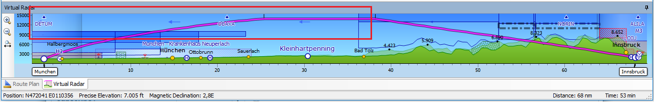

I am facing the same problem right now as the opener of this thead. Next month I will be flying to France for the first time. At the early time of planning I was not aware of the standard airspace structure in France. I just found by chance that several airspaces (even at lower areas, like E in Germany) are not displayed at all.
In my eyes, this is highly dangerous! Of course you say your software shouldnt be used as primary source, but lets be honest, why should I give you 100+ € per year if I need to use the map in flight anyway.
Attached you will find an simple planning from Munich to Innsburch at 14000 ft. Munich has a class C around it. But above FL100 theres just nothing! Somebody coming the opposite way from Austria in FL120 will think he's allowed to overfly Munich, because theres nothing above FL100.
You're able to put in a huge "Alpine Class C" in southern Germany, you're able to put in huge TMAs in Austria, you're able to put in thousands of smaller airpsaces all over Europe. I simply cannot imagine that theres a problem implementing the standard airspace structure of every country you cover.
I also must disagree with flip: If huge airspaces are slowing down your software, then it's your duty to work on your basic software!!! People are paying for this!
And, by the way: Wouldn't it be an idea to have the standard airspace structure of every country listed in the software somewhere? Something like the 10 basic rules of flying in France/Germany/Austria/UK/...
Right now I have a monthly subscription for testing, yesterday I was flying over the alps in 12000ft in my TMG. Knowing that some airspaces are missing makes me feeling really unsafe! Probably I won't be buying the full subscription until this issue is solved.
Best Regards,
Johannes König
tl;dr: Implement it! Software performace problems are your problems, not your paying customers ones. So you need to fix it!

We include all airspace whose lower level is below FL195, with the current exception of "blanket" controlled airspace at higher altitudes covering entire countries, which (as I believe may have been mentioned earlier) we assume pilots flying at those altitudes are already aware of.
To my knowledge we are missing no airspace at lower levels in the entirety of Europe.

You're right, comparing Skydemon with the ICAO chart, theres no difference. However, the traditional chart does not have the side view at the bottom. And your side view is definitely wrong without standard airspaces. Also, I think that the map doesn't show it because it cannot be drawn on a top-down-view. But a software allows us to do this, so why not improve it?
My suggestion is as follows:
1. For the top-down-view, do not show the standard airspaces. Basically, handle them the same way you handle country-wide NOTAMs. Hide them.
2. Hoever, in the side view, these airspaces should absolutely be visible! The picture I've attached to the earlier post is so horribly misleading.
3. Also, people must(!) be warned when approaching a standard A/B/C/D/E, like in the example with the FL130/FL100 Germany Class C. Almost every border has an altitude where there is an E/G on the one side and an A/B/C/D on the other.

You're missing the fact that we do not show that blanket airspace on the map. It's in virtual radar, it's in the flight details window if you plan a route through it, and it will show an in-flight warning if you approach it.
Jo, you state the performance issues resulting from the inclusion of large country-wide pieces of airspace in our calculations are our problem. You are correct, you just don't like how we have currently handled the problem, which is to omit the largest (most problematic) pieces of airspace from our data deliberately to keep a good general experience for the vast majority of our customers. I agree with you that our software would be better if these pieces were included, and I have planned some time in the future to see if there's any way we can mitigate the performance issues.
Do not underestimate the difference it can make including two 1,000 vertex polygons (that's the class C and class E) for Germany in our airspace hit-testing, which runs every time you change your route and every few seconds in flight. Anyone flying in the vicinity of Germany would be subject to this, which is many thousands of customers.
