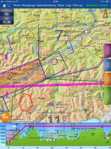

Ah! I hadn't thought of that. Yes, you'd need to consult AIP GEN 3.5 for the country concerned to see what their publication schedule is. Sometimes evening forecasts are only published during the summer. You can also use the Time slider to go back further than just the three two-hour blocks that are displayed by default.

I found the sollution. Everytime I tried it it was already night. The data seems to be published for daytimes only...

the new alpine GAFOR feature does not show up on my iPad mini. It did one time, days ago. The dashed lines are shown but not the GAFOR states. I have the latest iOS and tried to reinstall the app but without result. What can I do? Is there anyone having the same problem? Thanks for your help!
