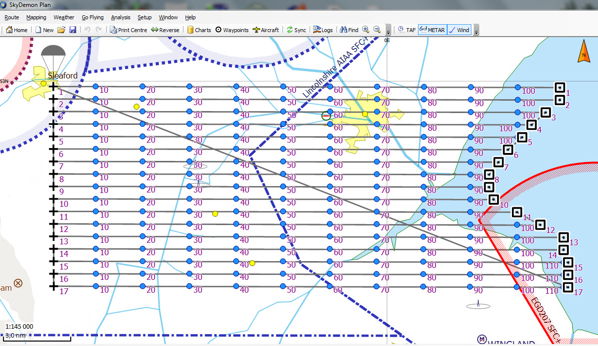

In recent 2 photo flights I was watching how SD looks in the air (stage 30 min...). Introduced 4 lines manually as custom area - not very efficient.

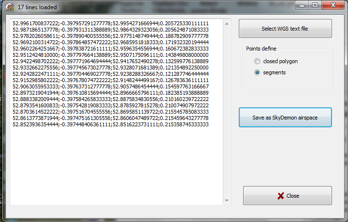

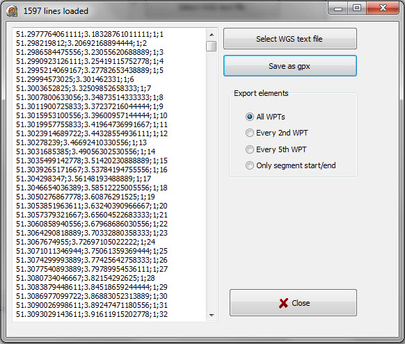

Yesterday I wrote a little program to create custom waypoints based on original flight planning output (IGI WinMP -> WGS WPT export). The idea came after studying BGA 2013 turning points' file structure, available for SD.
My program converts the set of WGS coordinates into *.gpx file that can be imported in on PC, then from PC saved to the cloud. My mobile device at this moment is an Android tablet (1 GB RAM).

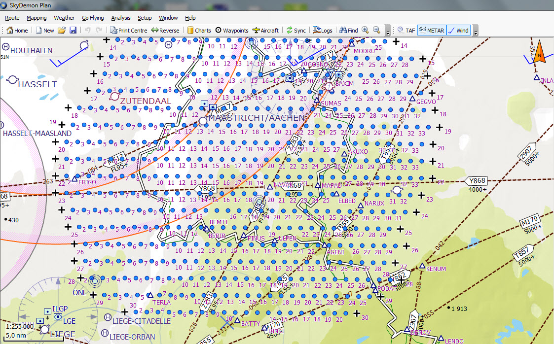

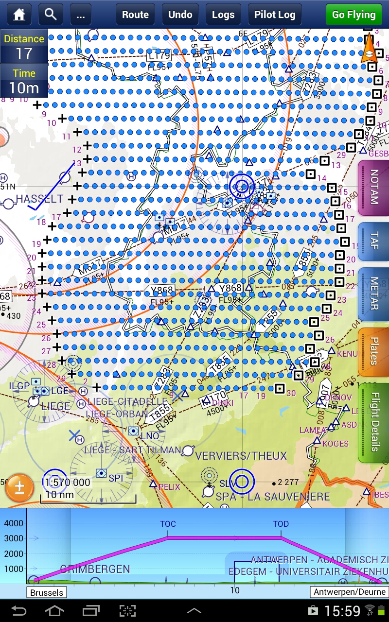

After WPT-s I changed to creating airspace files in order to show photo lines.
Find enclosed 2 screenshots: photo lines are loaded as airspace (1st and last lines are connected - closed polygon is a must) and a moderate size WPT.GPX is also loaded.
If one prefers to have lines on screen as a route: airspace file can be converted to route file with some copy-pastes. Looks good, but the 1-2 second delay of the HSI needle made me doubts, do I really need it. The dedicated photo equipment has professional GPS and the position is extrapolated using known delays in position calculation.
