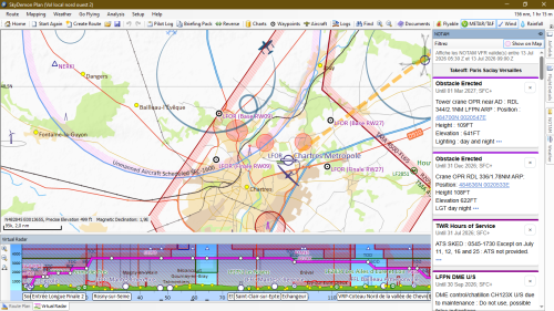

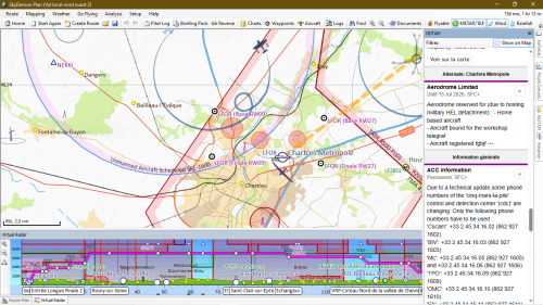

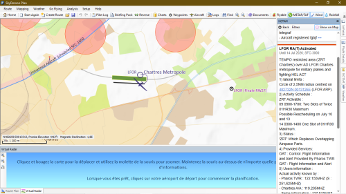

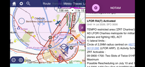

 I would like to report an issue I have with PC version. Indeed, during flight preperation I planned a flight and noticed that on PC version, a notam for ZRT activation for Chartres AD (LFOR) was neither shown on NOTAM tab nor on map, while :
- I can see it when I check on AD NOTAM of PC version (but it is not shown on map);
- I can see the NOTAM on Iphone version when planinng the same flight.
I checked that the time period is correct (between the flight planning and activiation period of the ZRT) and "shown on map" option was on. I include some screenshots from the PC version to illustrate the issue and also from Iphone version. Could you inverstigate the issue? I am worried about this issue as I except to get accurate data without any discrepencies with AIP (and between Skydemon versions), especially for a ZRT (=Temporary Restricted Area) involving military operation.
Thank you
Julien

Thank you for your reply. Yes, I set the flight to be flown on 13th (the quality is not good but it you can see it for the PC on the 2nd screenshot starting from upward) on both PC and IOS, as I save the flight on the cloud and opened the flight from the saved flight. I looked at the date and hour to be sure it is the same both on PC and IOS.
I tried to change the hour on PC for the 13:
-at 06:00 Z => no NOTAM,
-at 07:00 Z => no NOTAM
-at 08:00 Z => the NOTAM shows up
while with IOS is already included at 06:00 Z, but if I plan the flight at 05:00 Z, the NOTAM is gone.
It's like there is a time reference between IOS and PC while I checked and  both are configured in Z / UTC. Indeed, for IOS the NOTAM shows up at 06:00 Z which corresponds to 08:00 local time (Z / UTC +2), and for the PC the NOTAM shows up at 08:00 Z, but could it be set (bug?) in local time instead of Z / UTC ?
Could you try to set the flight on IOS and PC before and after 06:00 Z, as I did, to check if you have or not the NOTAM?
