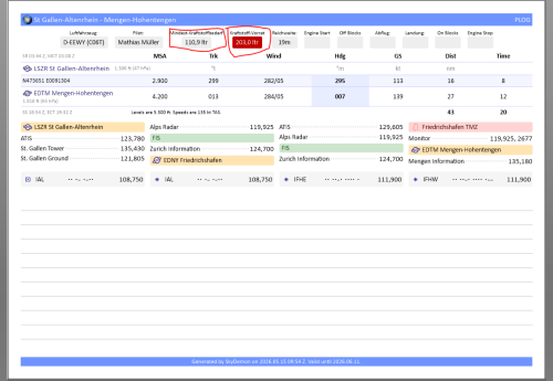

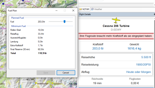

Hallo,
i did make a custom profile with with weight & balance and fuel consumption for Cessna 206 Turbine i fly.
But 206 turbine tanks a rather small, most of the time skydemon say fuel is not enough for the planned route.
The difference between whey skydemons it says it is ok is around 90 Liter more fuel then minimum required fuel.
can not figure the hack how it says this all time what i are missing because minimum fuel requirment is stil way below the fuel in the tanks for fuel planning.
Any Idear?

The only thing I can think of is that the minimum weight on the W&B envelope is set too high, so you need more fuel to get the plotted figure within the envelope.

checked again was all ok in the W&B department.
But somehowe had 150 liter unusable fuel in the settings, that explains alot
User error, thx for thelp
