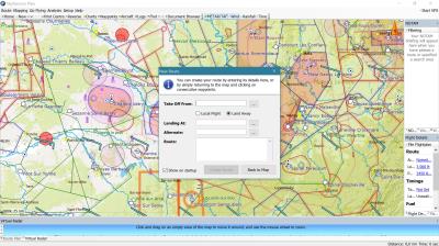

Hi all,
I updated to the newest PC version (3.5.0) and when running it on my high res screen(3200*1800)  under Windows 10, I am  unable to use the software. Very tiny menu icons, very small virtual radar and tight side bar.
Any ideas?http://forums.skydemon.aero/uploads/images/a33349a4-46d6-483b-9f2d-36bf.jpg
Edit : found how to increase lateral bar and virtual radar, but top menu and virtual radar controls are still very small.

I found a solution by tweaking the "skydemon.exe.manifest" file and setting the <dpiAware> flag to false.
Not elegant but makes Skydemon usable on my high res screen.
