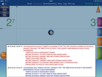

Hi forum,
since yesterday, when I'm starting skydemon on the iPad, I'm always getting the attached error messages.
What is the problem???
Greetings from Germany,
Oli

I notice that the TAF is an amended TAF  Thus immediately after the "TAF" text there is the code "AMD" and then the ICAO Airport identifier.  In an ordinary TAF the ICAO airport identifier directly follows the "TAF" text.  Perhaps Skydemon is not parsing the TAF text string correctly?

Hi George,
thanks for your answer. I don't know what happened, but today everything works fine...no messages at startup.
