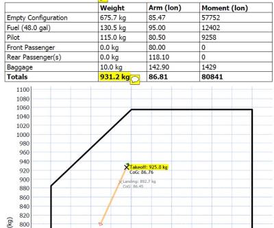

I have just updated SD Plan to version 3.2.0.0 and have dissovered that there seems to be an error in the WnB
If I look in the WnB as presented in the Print Center - numbers listed in the table do not correspond to numbers shown in envelope graphic
They should be the same no? (Table is correct - graphic is off - both in weight and datum)
http://forums.skydemon.aero/uploads/images/91955c5c-2e20-4adc-bc60-9ac6.jpg

The difference is probably the fuel used during taxi. Did you specify taxi fuel consumption?

Good catch - sure I did (or actually 30 min holding time).
I guess I will have to learn that with SkyDemon everything is accounted for. In the old "paper world" take of weight was based on the amount you filled in the tanks at the fueling station...
Thanks Chris...
