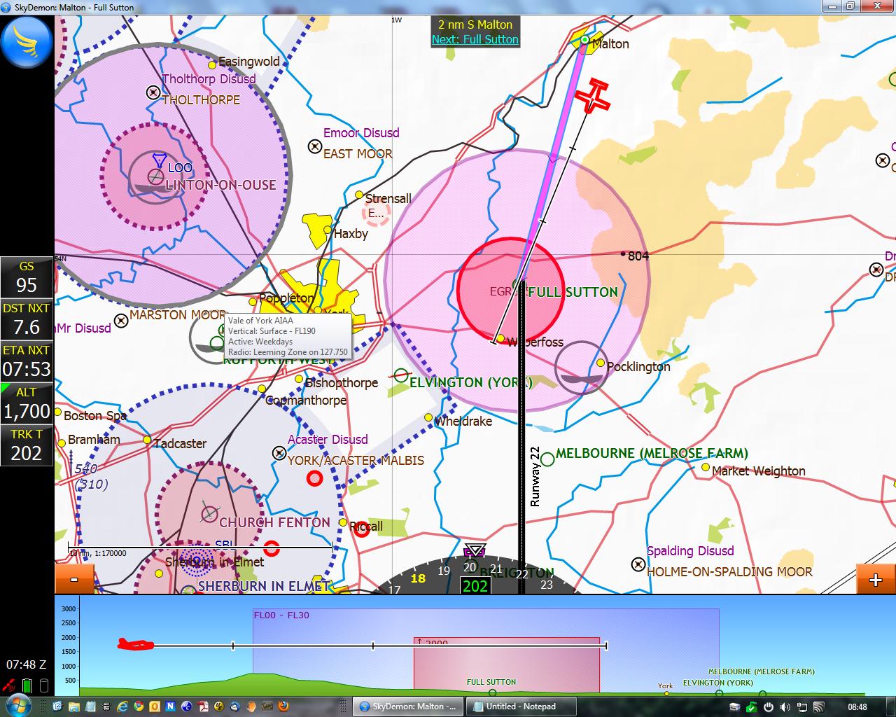

Mr_rodge, you're not alone.
I also have the same problem with FS.
Simulated GPS on Plan:
If doing a Southerly approach, the Instrument view crashes when close to the airfield.
If doing a Northerly approach to runway 22, I get the same strange extended runway centreline as you did.
Could others try the simulated GPS approaches to ensure that mr_rodge & I haven't got corrupted installations?
(Did a fresh install of SkyDemon 2.1 prior to the tests)

Full Sutton Northern App.jpg (559 views, 244.00 KB)

Just to confirm that I tried it om my simulator moded and the same happened, I got an unhandled exception (whatever that means, with these details) if they are any help.
See the end of this message for details on invoking
just-in-time (JIT) debugging instead of this dialog box.
************** Exception Text **************
System.OverflowException: Overflow error.

I can confirm that we're seeing this here too, and it's do to with the specific way that runway data has been entered for Full Sutton. We'll release a hotfix build within a few days.
