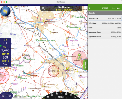

Ok, had a modified checklist set up on my iPad as shown:
Then closed SD down and restarted and get this:
So some bits are retained but not all...

Thanks Tim, although maybe not the intended use of the checklist function, it maybe of interest to see that I've used it to provide a reminder of key speeds (as I swap ac regularly)  and also Basic/Traffic service request format.
