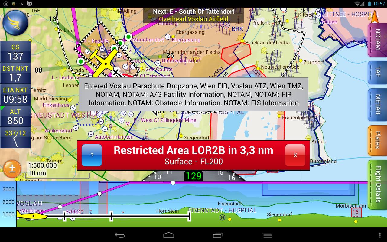

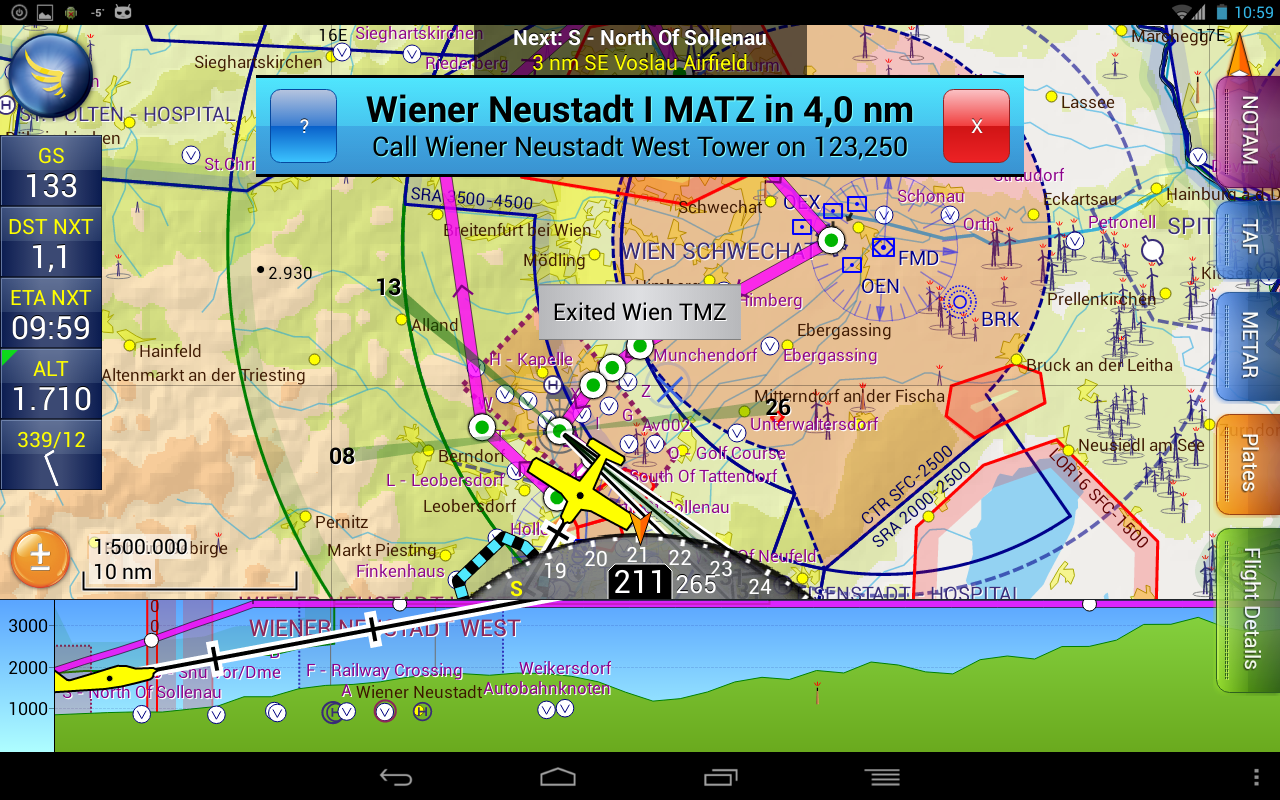

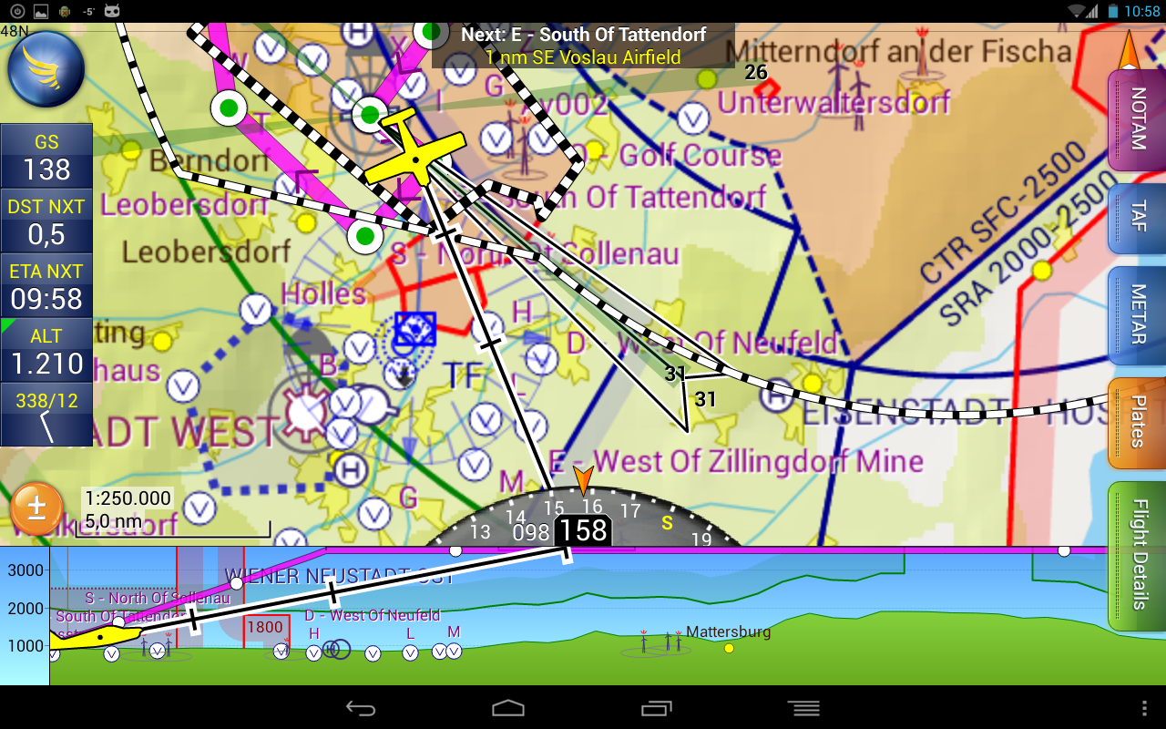

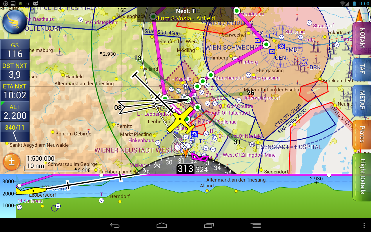

Hi, I worked now 5 hours with my Android tab and it realy deos a great job. However, I note, that on my Galaxy 8.9 Tab, the screen is used very ineffectively.
For example:
The magenta course line and the yellow airplane symbol is much too large (I used scale 1:500k and 1:250k)
The bottom Terain clearance is much too large
The buttons on the right side of the screen are much too large
The informational Messages popping up onto the screen are much too large
I have attached screenshots so you can see what I mean.
Sorry I cant upload attachements with IE-10, did it with Chrome
